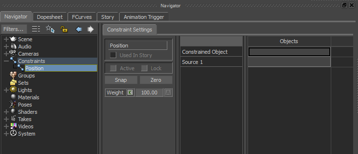

Drag the Position constraint asset from the Asset browser pane into an empty area in the Viewer window.
The Position Constraint settings display in the Navigator window.

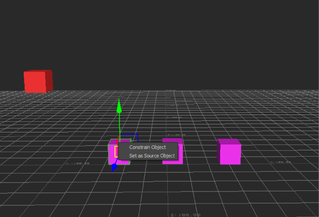

Drag the Position constraint asset from the Asset browser pane on top of an object in the Viewer window.
The context menu
appears.If you drag the constraint on top of an object, a context menu appears asking if you want to assign the object as the constraint’s Source or Constrained objects.
Constraint context menu
Assign the object that you want to position and translate in the scene based on the position and movement of one or multiple source objects to the Constrained (child) object cell.
Assign the object that you want to derive the translation information from for the constrained object to the Source 1 (parent) cell.
When you drag an object into the Source 1 cell, another source (Source 2), is added to the Objects pane. If you drag a second source into Source 2, the position of the constrained object is derived from the position of the two source objects.
You can have as many sources as you want, so you can create complex Position constraints.
Note:When more than one source is specified, the constrained object is placed at the middle point between all source objects.

Click Lock in the Constraint settings to lock the position of the objects to be constrained.
Click Active to activate the constraint.
