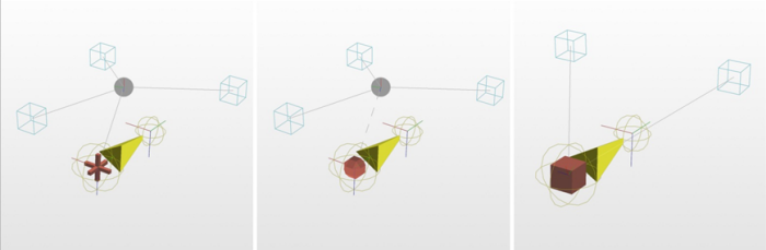

Extraction Types
You can use these extraction types on a set of markers to get the rotation and translation of a goal: position and rotate joint in markers, rotate joint in markers, and aim joint at markers. The following figure shows the extraction types.
