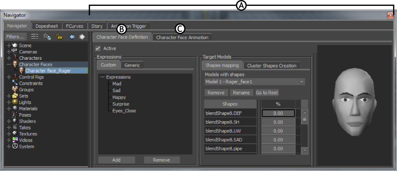

When you add a Character Face asset to the scene, the Character Face settings display in the Navigator window. These settings let you create facial expressions, rename shapes, and use the Voice device for real-time lip synchronization with facial animation.
The Character Face settings consist of the following main areas:
  • Character Face Definition pane
  • Character Face Animation pane
    Navigator window A. Character Face settings B. Character Face Definition pane C. Character Face Animation pane
