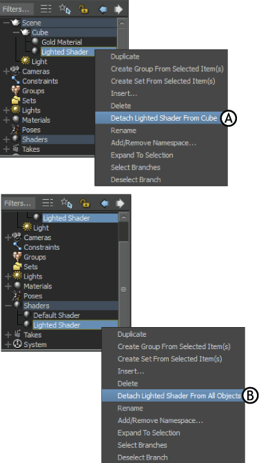

Detach/Detach All Assets
Lets you detach all assets from a model or other asset with materials, textures, and shaders. This menu item changes depending on the selected assets and where you right-click.
Right-click a material, texture, or shader in the Scene folder to detach the asset from its parent. For example, if you right-click a shader attached to a cube, the context menu item asks if you want to detach the shader from the cube.
Right-click a material, texture, or shader in its dedicated folder to detach the asset from all attached objects. For example, right-clicking a shader in the Shaders folder displays a menu option that lets you detach the shader from all attached objects.
A. Detach From Asset B. Detach From all Objects

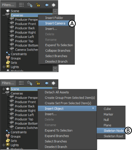

Insert Folder
Lets you add additional folders to the Asset list when you right-click a folder. You can reorganize your list of assets by dragging them into folders.
For example, you can separate your custom cameras in their own folder by right-clicking the Cameras folder and selecting Insert Folder from the context menu. The new folder inherits its Asset folder name. Rename folders by right-clicking the folder, and selecting Rename from the context menu.
A. Added folder in the Cameras group inherits its parent folder name (Cameras Folder)
You can add folders to any Asset folder, but you cannot add folders under the Scene folder since it displays a hierarchical view of your entire scene.
Insert
Lets you add an asset to your scene where matches the folder that you right-click.
For example, right-clicking the Cameras folder lets you add a custom camera, while right-clicking the Scene folder provides an additional submenu, letting you add any object.
Insert A. Insert Camera B. Insert Object

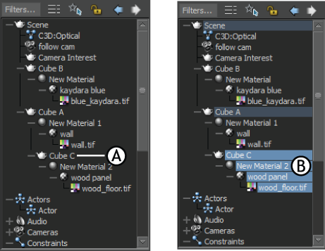

Select/Unselect Branch
Selects or deselects all the assets connected to the branch that you right-click. For example, right-clicking on a cube and choosing Select Branch selects the cube and its child assets.
Select Branch A. Right-click on Cube C and choose Select Branch. B. Cube C and all its child assets are selected
You can also use Select Branch and Unselect Branch with Asset folders. For example, you can right-click the Textures folder and choose Select Branch to select all the textures in your scene.
