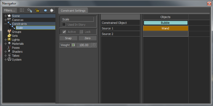

The Scale constraint lets you constrain the scaling of one object relative to the scaling of one or many other objects.
Scale constraint
Constrained Object
An asset, model, or other object whose orientation derives its size from the Source object(s). Also known as the “child” object.
Source
Sends scaling information to the constrained object. You can have multiple source objects for this constraint. Also known as the “parent” object.
