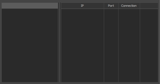

Add the Network Server device to use MotionBuilder as a server to which you can connect other computers running MotionBuilder. The devices connected to the Network Server computer can be used by all other computers that are connected and running MotionBuilder.
Network Server device settings
For the Network Server to function properly, MotionBuilder must be running on a computer connected to a LAN or another network with an IP address.
