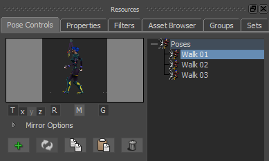

  2. In the Pose browser, double-click the “Walk 01” pose to paste it on Mia.
    By default, the Gravity, Translation, and Rotation options are active in the Pose Controls window. This means that the translation and rotation of the pasted pose match the translation and rotation of the selected effector on the current character. The Gravity option ensures that the feet stay at the original level of the pasted pose (normally floor level).

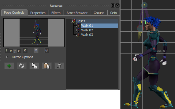

  3. In the Transport Controls, ensure you are at frame 0 ( ).

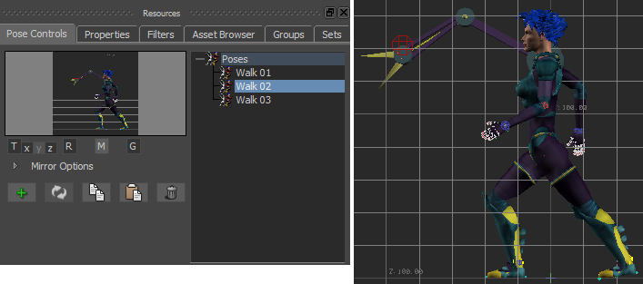

  11. Paste the Walk 02 pose on Mia and set a Flat keyframe.
    • In the Pose Controls Pose browser, double-click the Walk 02 pose.
    • In the Key Controls window, click Flat (or use the keyboard shortcut Ctrl-K).

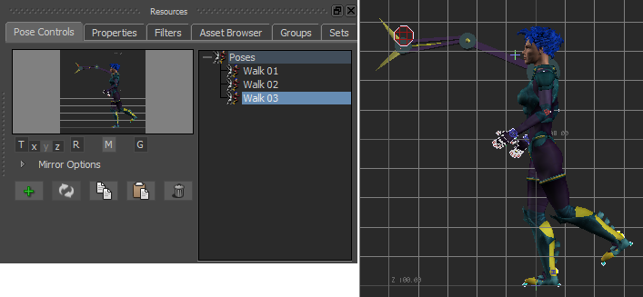

  13. Paste the Walk 03 pose on Mia and set a Flat keyframe.
    • In the Pose Controls Pose browser, double-click the Walk 03 pose.

    Frame 0: (Walk 01) First pose (pasted on Mia) for the walk cycle
    Frame 4: (Walk 02) Second pose (pasted on Mia) for the walk cycle
    Frame 8: (Walk 03) Third pose (pasted on Mia) for the walk cycle
