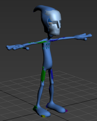

    The 3ds Max scene loads, displaying a biped skeleton inside a mesh.
    3ds Max biped skeleton inside a mesh
    Important:
    It is recommended to place your characters in the “T” stance before sending them or exporting them to MotionBuilder.

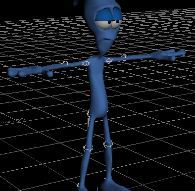

  7. From the Application menu ( ), select Send to Send to MotionBuilder Send as New Scene.
    The 3ds Max scene (Pepe character and camera) loads into MotionBuilder.
    3ds Max Pepe character displayed in the Viewer window
    The established connection between 3ds Max and MotionBuilder is indicated in Viewer window status bar ().
