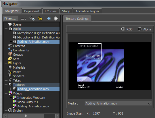

If you load a video file containing video and audio via the Asset browser and drag it to the Viewer window to Add to Scene, the asset's video and audio is loaded in the Navigator window's Scene browser:
  • The asset's audio is added to the Scene browser's Audio branch.
  • The asset's video is added to the Scene browser's Textures' branch and Videos' branch.
    Navigator window showing file's audio and file's video added as texture and video assets
To load a video file with audio in the Viewer window via the Asset browser:
  1. In the Asset browser, drag a video asset in the Viewer window.
    A context menu appears.
    Adding a video asset to the scene
  2. Select
    The asset's audio is imported to the Navigator window's Audio branch, and the asset's video is imported to the Navigator window's Textures branch and Videos branch. This enables you to use and set the audio, texture, and video settings of the imported file.

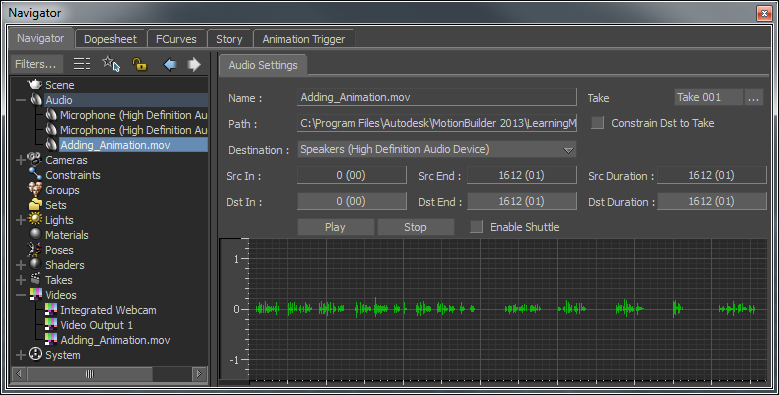

If you load a video file containing video and audio via the Asset browser and drag it to the Videos' branch in the Navigator window:
  • The asset's video is added to the Scene browser's Videos' branch.
Navigator window showing file's audio settings and file's video added as video asset
To load a video asset from the Asset browser to the Navigator window Scene browser:
  • In the Asset browser, drag a video asset in the Navigator window and drop it onto the Videos branch.

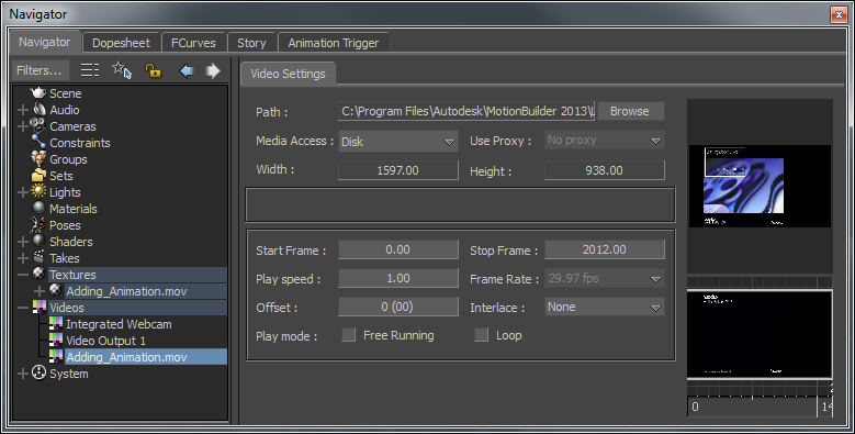

If you load a video file containing video and audio via File > Import Video, the asset's video is loaded in the Navigator window's Scene browser:
Navigator window showing only file's video added as video asset and video texture
If you load a video file containing video and audio via the Scene browser's Videos branch, the asset's video is loaded in the Navigator (window) Scene browser:

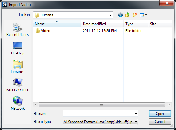

To add a video asset to the scene via File Import Video:
  1. Select File Import Video.
    Tip: In the Import Video dialog, click the Files of type field to find out which file formats are supported.
  2. In the Import Video dialog, navigate to the location where your file resides.
  3. Select the file and click Open.
    The asset's video is added to the Scene browser's Textures' branch and Videos' branch and the asset's settings are displayed in the Navigator window's Video Settings' tab.
To add a video asset to the scene via the Navigator (window) Scene browser:
  1. Right-click the Videos' branch and choose Insert Video from the context menu.
    The asset's video is added to the Scene browser's Textures' branch and Videos' branch and the asset's settings are displayed in the Navigator window Video Settings pane.
