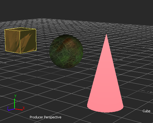

  3. Hover over an object.
    The object highlights.

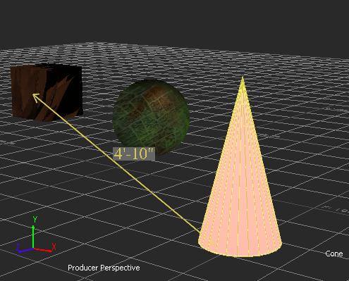

  4. Click the object and go to the next object.
    The measuring distance displays and updates dynamically as you start to move the cursor.
  5. Click the second object.
    The system Ruler "object" is created and displays the distance between the two objects.
    Ruler "object" displaying the distance between two objects

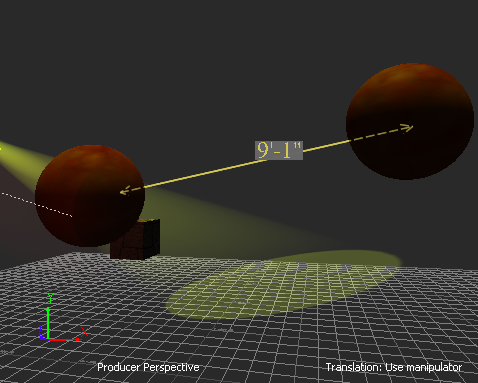

To edit the distance between two objects:
  1. In the Viewer window, click either of the two objects whose distance is measured.
  2. In the Viewer window toolbar, click the Translate tool () (or press T).
  3. In the Viewer window, drag the object to the desired position.
    The system Ruler "object" remains snapped to the objects and the distance between the two objects updates dynamically.

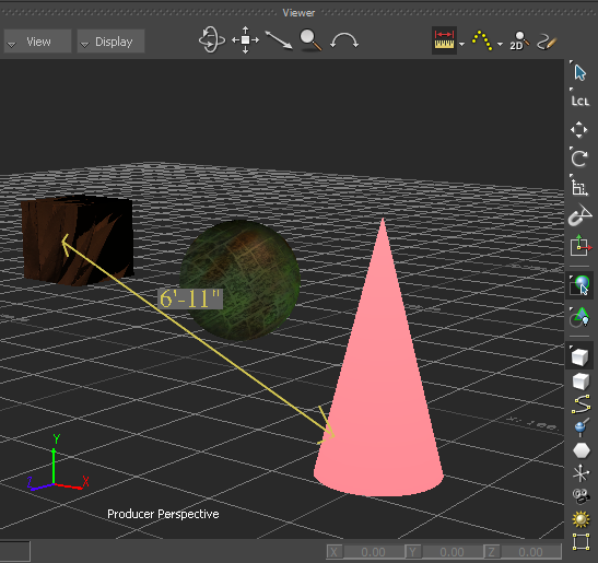

    The system Ruler "object" is shown as a dashed line when it is occluded, as seen in the following figure.
    Ruler shown partially occluded
