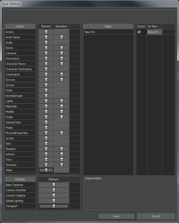

The Save Options dialog appears.
Use the Save Options dialog box to select which assets, settings, and takes to save.
See Save Options window.
Click Save to save the selected assets, settings, and takes to the specified .fbx file.
