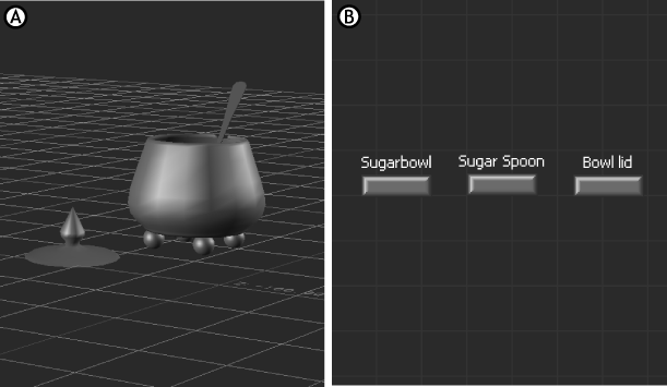

For example, in the following figure, sugar bowl, lid, and spoon models are shown as separate objects. In the hierarchy, they are shown as equals. Each model can be moved independently.
Unparented sugar bowl, lid, and spoon models A. Viewer window B. Schematic view of the same objects.

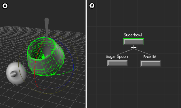

In the following figure, the sugar bowl is parented to the lid and the spoon. When you rotate the bowl, the spoon and the lid follow it. In a hierarchy, the spoon and lid are shown as children of the sugar bowl node.
Parented sugar bowl, lid, and spoon models A. Viewer window B. Hierarchical Schematic view of the same objects.
