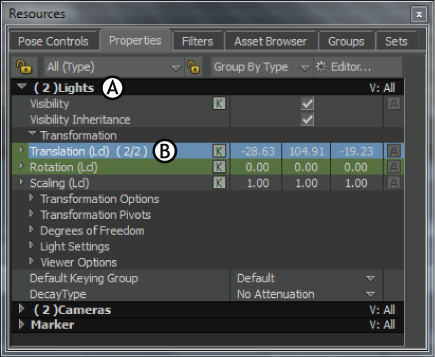

Group By Type
Elements of the same type are grouped together. For example, in the following figure, the lights are grouped (A). You can modify the properties of all models at the same time, but modify the properties of lights separately from models.
Properties window A. Grouped objects of same type B. Grouped objects’ translation properties

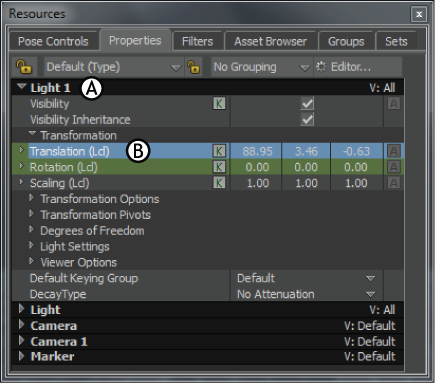

No Grouping
All elements are listed separately, letting you modify each property individually without affecting other elements. For example, in the following figure, all selected objects are listed one after the other.
Properties window A. Light 1 is not part of a group B. Light 1 translation properties
