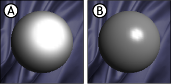

Shininess slider
The Shininess slider lets you define the level of light reflected on a material. Adjust this slider to control the distribution of an object’s specular highlight.
Low values result in a large, soft glow, and high values define a smaller, sharper highlight. For the best results when adjusting the Shininess value, also play with the color and intensity of the Specularity settings.
Material proxy A. Material with low Shininess value B. Material with a high Shininess value
