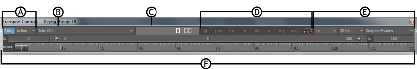

Transport Controls window A. Story Mode option and menu B. Current Take menu C. Timecode field D. Play Controls E. Timing Controls F. Action timeline

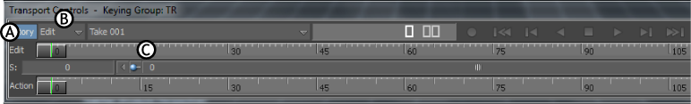

The Story Mode option lets you activate and disable the animation in the Story window. The Story Mode menu lets you select between Action and Edit modes, which determines which part of the scene plays.
Transport Controls window A. Story Mode option B. Edit selected in the Story Mode menu C. Edit timeline displayed
When Edit is selected in the Story Mode menu, the Edit timeline displays in the Transport Controls window.

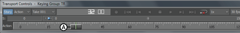

The Timeline indicator indicates the frame or time in the current take and lets you change the current time. When the current take plays, the Timeline indicator moves from left to right along a timeline. You can drag the Timeline indicator along the timeline to change the current time.
Transport Controls (detail) A. Timeline indicator
You can change the size of the Timeline indicator using the Small Cursor option (see Display). When the Timeline indicator is smaller, it is easier to view and edit visual keyframes.

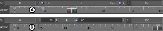

For example, the following figure shows the Zoom feature active and disabled. When Zoom is disabled, the full length of the take that is defined by the Start and End fields (0 to 150) displays on the Action timeline, and the Zoom bar is at full size.
When Zoom is active, a portion of the current take fills the entire space on the Action timeline (30 to 60), which is defined by the values in the Zoom Start and End fields.
Action timeline A. Zoom disabled and Action timeline reflects the values in the Start and End fields B. Zoom active and Action timeline reflects the values in the Zoom Start and End fields
