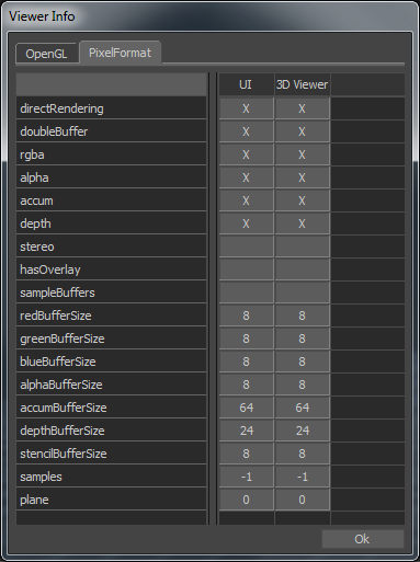

The Pixel Format pane displays the supported UI and 3D Viewer default setup of your OpenGL graphics card.
OpenGL Viewer Info PixelFormat pane
An X displays in any column that supports the specified value.
Note:
You cannot modify information in the PixelFormat pane. The displayed information is for reference purposes only.
Pixel Format settingsDescription
UI
The UI setting specifies the supported value of the pixel format for the User Interface (UI). This setting does not affect the Viewer window display.
3D Viewer
The 3D Viewer specifies the supported value of the pixel format value of the Viewer window.
