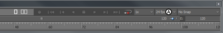

To select one of the main frame rates:
In the Transport Controls, select one of the options in the Time Format field.
Transport Controls A. Time Format field
The frame rate is selected in the Time Format field, and the unit of measurement is changed. See Time Format menu for more information.

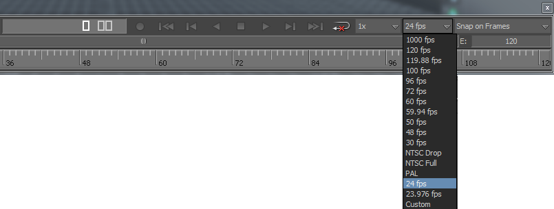

To select a custom frame rate:
Click the Time Format field in the Transport Controls, then select Custom from the menu.
The Custom Frame Rate dialog box appears.
Enter one of the following frame rates in the field:
If you enter a value other than one of these supported frame rates, the next highest supported frame rate is selected.
Click Ok or press Enter.
The custom frame rate is selected in the Time Format field.
Transport Controls A. A custom frame rate is selected
