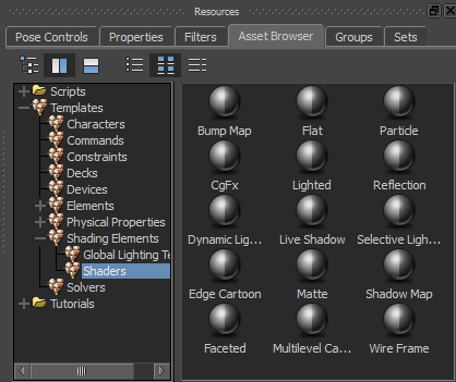

  1. In the Resources window, click the Asset browser tab.
  2. In the Asset browser, expand the Shading Elements folder and click the Shaders folder.
    The Asset browser displays by default a thumbnail view of the shaders.
    Thumbnail view of the shaders in the Asset browser

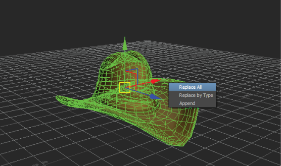

  3. Drag a Shader asset from the Asset browser onto a model in the Viewer window.
    A context menu appears.
    Viewer window A. Shader context menu
  4. Select an option from the context menu.
    Context menu optionDescription
    Replace AllReplace All replaces all shaders applied to the object with the selected shader.
    Replace by TypeReplace by Type replaces all shaders of a certain type with the selected shader.
    AppendAppend adds the selected shader to shaders already applied to the object.
