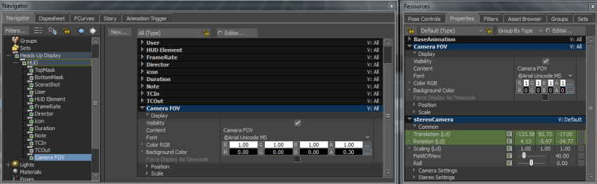

  4. By pressing the Ctrl key, click the Camera FOV HUD element in the Navigator window.
    Both the properties of the Camera FOV HUD element and the stereoCamera asset appear in the Resources > Properties window.

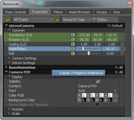

  5. Click the Field Of View property under the Resources > Properties > stereoCamera properties, and then drag it and drop on the Camera FOV HUD element properties.
    The Create 1 Reference Property context menu option appears.

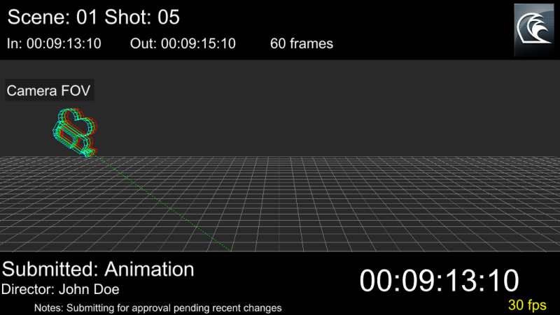

  6. Click the context menu option to add the Field Of View property to the Camera FOV HUD element properties. The value of the Field Of View property appears in the Viewer.

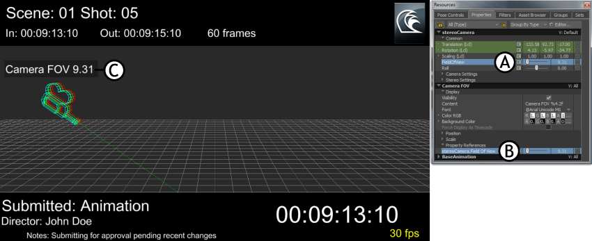

    Viewer and Resources windows A. Field Of View property B. Field Of View property added to Camera FOV HUD element properties C. Field Of View property value
When you adjust the value of the Field Of View property, the change in value appears dynamically in the scene.

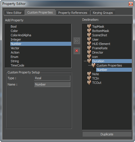

  1. Click the Editor button in the right pane of the Navigator window.
    The Property Editor window appears.
  2. Click the Custom Properties tab.
    • The Add Property pane displays the custom properties.
    • The Destination pane displays all HUD elements that you added.
  3. In the Add Property pane, select a custom property.
  4. In the Destination pane, select a HUD element to which you want to add the custom property.
  5. Click Create Custom Properties of the selected type button.

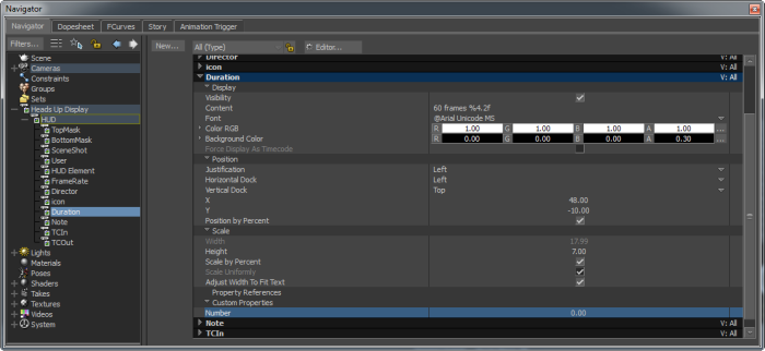

In the following figure, the Number custom property is added to the Duration HUD element.
The Number custom property appears in the Duration HUD element properties.
