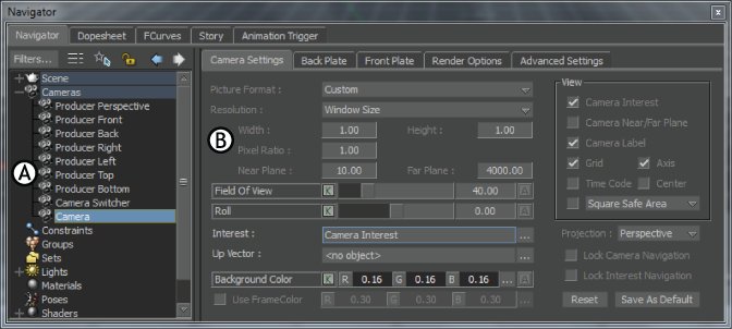

To access the Camera settings, open the Cameras folder in the Scene browser, and double-click a camera to display its settings. These settings also display if you select a camera in the Viewer window.
Camera settings A. Cameras folder B. Camera Settings

Camera Settings pane
The Camera Settings pane contains the settings for configuring the selected camera’s view areas.

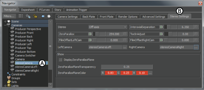

When you add a Stereo camera to your scene, a Stereo settings is added to the Navigator window.
Camera settings A. Stereo camera B. Stereo Settings pane
