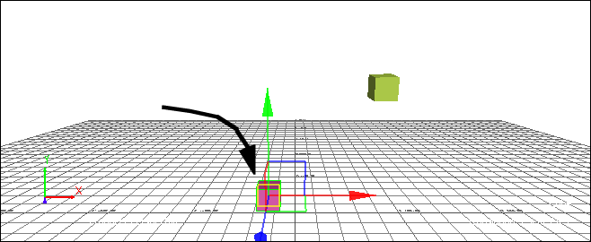

  1. Drag two cubes from the Elements folder of the Asset browser into the scene, positioning them similar to the cubes in the following picture.
Optional: You can change the color of the two cubes by adding a material to each, then changing the Diffuse property.

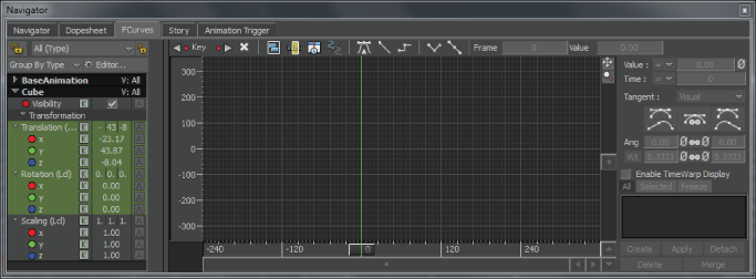

  1. Select the cube on the left, then open the FCurves window if it is not already open in the current layout.
FCurves window
The properties of the selected cube display in the FCurves properties pane as well as in the Properties window.

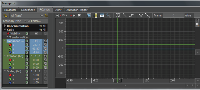

  1. In the FCurves window Properties pane, click the Translation (Lcl) header to select the cube’s Translation properties.
Cube’s Translation properties selected, showing the function curves
The cube’s translation properties are selected and their representative function curves display. Right now, the function curves are flat because the cube is not yet animated.
The color of the function curves correspond with the color of the axis they represent. By default, the function curve for the X-axis is red, the Y-axis is green, and the Z-axis is blue.

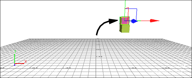

  2. Go to frame 30 and translate the first cube until it sits on top of the second as shown in the following figure, then set another keyframe.

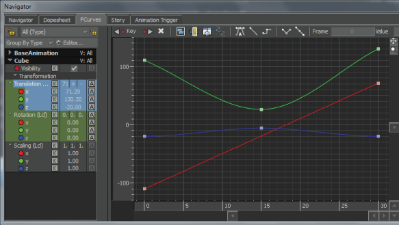

  1. Click in the FCurves pane, then press A to frame the function curves.
Function curves framed
  1. Drag around the three keyframes on frame zero to select them.
    Tangent handles display on the selected keyframes, and their coordinates display in boxes on the horizontal (time) and vertical (value) axes.

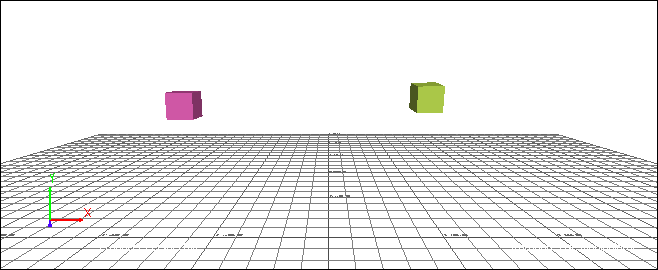

  2. In the Transport Controls window, drag the right Stretch handle on the Zoom bar to 60.
    This zooms on the animation from frame 0 to 60, adjusting the Action timeline to the length specified by the Zoom time codes.
  3. Play the animation using the Play Controls in the Transport Controls.
