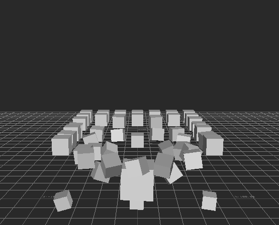

Example: Grid Collision
Sample Viewport Output:
Program Summary: In the following program, a large cube collides with a grid of smaller cubes below it. The large cube's Rigid Body Physical Property has its Activation set to 0 (active), allowing it to fall when the program is run. The Rigid Body Physical Property bound to the smaller cubes has its Activation set to 1 (active on collision), making the smaller cubes fall to the ground plane if they experience a collision.
