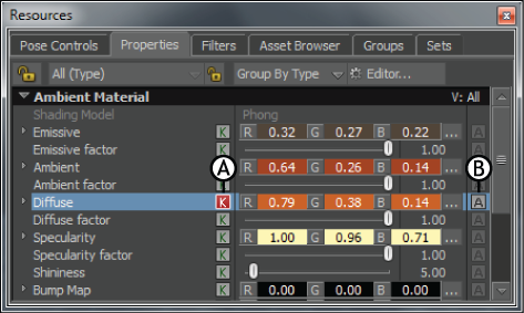

Properties window A. Keyframe button B. Animate button

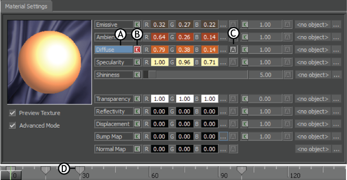

Asset Settings area A. Diffuse property selected B. Keyframe button C. Animate button D. Keyframes of Diffuse animation on the Action timeline

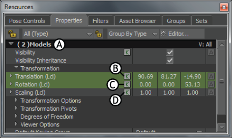

    Properties window A. Two objects selected B. Translation of both objects keyed at the current time C. Rotation of one object keyed at the current time D. Neither object has a keyframe for scaling at the current time
