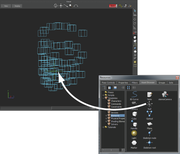

From the Elements folder in the Asset browser, drag a null into the scene.
Since the null will be the Reference object, make sure it faces the same direction as the motion data markers.

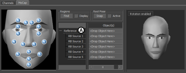

In the Actor Face settings, switch to the MoCap pane and expand the Reference group.
MoCap pane in the Actor Face settings A. Expand the Reference group

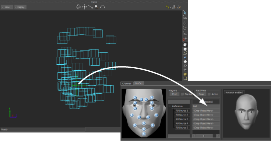

Alt-drag the null from the Viewer window into the Reference slot.

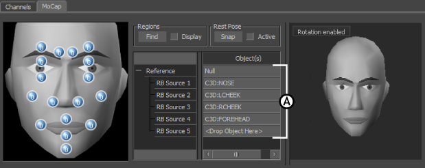

Identify a group of markers that do not move relative to each other, such as the forehead markers, and drag them into the series of Rigid body slots (RB Source 1, RB Source 2, and so on) in the Reference group.
Actor Face settings A. Rigid body sources
