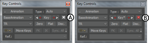

  2. Click Delete in the Key Controls window.
    Keyframe buttons A. Delete button unavailable when there is no key at current time B. Delete button available
