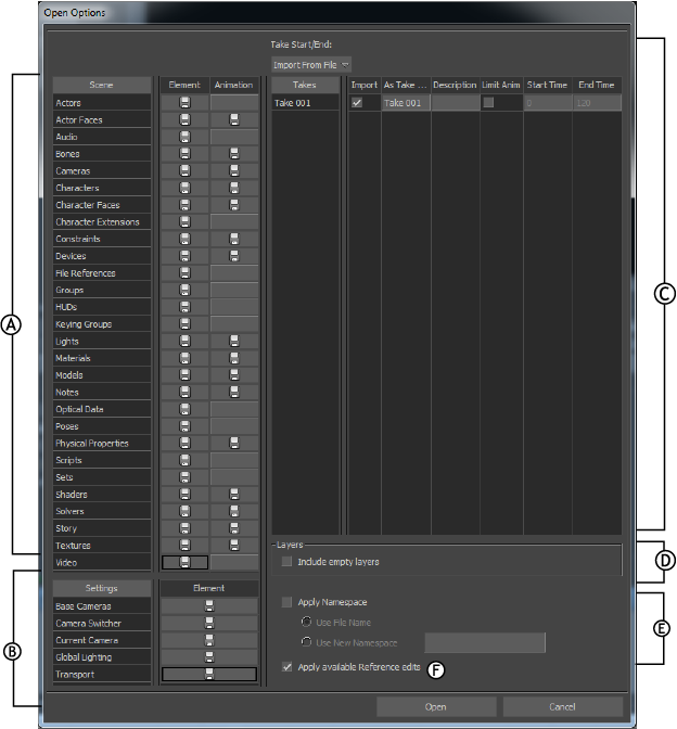

Use the Open Options window to select elements, animation, settings, takes, layers, and Reference edits —if applicable—to load, and to prepend a namespace for all objects included in the incoming file. Under Elements, Animation, and Settings, this icon
indicates what is loaded, while this icon
indicates what is discarded when the file is loaded into MotionBuilder.
Open Options window: A. Scene area B. Settings area C. Takes area D. Layers area E. Namespace area F. Reference edits area
MotionBuilder retains the last Open Options settings you used. Make sure to always check whether there are any assets, elements or other settings that are ignored before you choose to load your file.
Scene
Lists each MotionBuilder asset that you can load from the .fbx file being opened.
Although each asset is listed under Scene, it does not mean that the file being loaded contains these assets. For example, if the .fbx file you are loading does not contain Light assets, the Lights element is still listed.

Settings area
Lets you select the MotionBuilder settings to load from the file being opened.
Base cameras

Takes area
Shows all the takes stored in the .fbx file that you are opening. You can also set how the start and end of each take is determined as well as the name given to each take.

Namespace area
Lets you prepend a namespace for all objects included in the incoming file.
Apply Namespace
