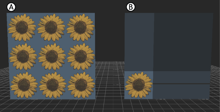

In the following figure, two planes have the same texture applied, but each uses a different mapping method from the U/V tile menus.
The same striped texture on two planes A. Texture set to U and V Repeat. B. Texture set to U and V Clamp.
Both menus let you choose one of two options, Repeat and Clamp:
OptionDescription
RepeatApplies the texture over and over on the model’s surface until the model is covered. This is the default setting.
ClampApplies the texture to a model only once, using the color at the ends of the texture as the “filler”.

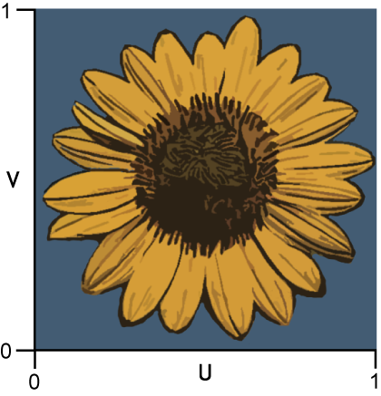

A texture’s U and V values range from 0 to 1.
