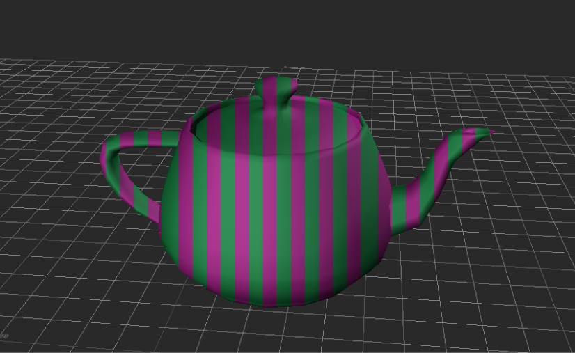

Projective textures
Projective textures project an image onto an object’s surface as if it was a slide. You can use projective textures to create shadows and spot light effects, among other things.
Projective textures do not require specific UV mapping coordinates, unlike textures intended to fit the shape of the model.
Projective textures cause strange effects when used on three-dimensional objects, as they do not recognize the object’s shape so much as project directly onto the front of it.
In the following figure, note how the striped texture does not recognize the curve of the teapot's lid, bowl, spout, or handle
Teapot model with Projective texture
