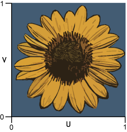

A texture’s U and V values range from 0 to 1.
To scale a texture from its center, for example, enter a value of 0.50 for both U and V properties, placing the texture’s scale pivot in the middle of the texture.

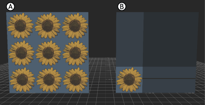

Select Repeat in both U Tile and V Tile menus to let your texture tile in both directions. Otherwise, select Clamp from either menu.
Note:If both U Tile and V Tile menus are set to clamp, your texture will not tile.
Same texture on two planes, with Scaling set to 3. A. Texture set to U and V Repeat B. Texture set to U and V Clamp
