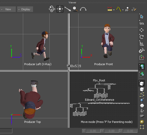

Viewer Layout
The Viewer Layout menu option enables you to display a single pane, two panes, three panes or four panes.
The two-pane layout option displays two Viewer panes, the three-pane layout option displays three Viewer panes, and the four-pane layout option displays four Viewer panes.
Four-pane Viewer layout
Each pane can use a different camera view, so you can view your scene from different perspectives at the same time. You can also show the Schematic view in any of the Viewer window panes.
When the Viewer window is split into multiple panes, move your mouse over the pane to activate it. You must make a Viewer window pane active, before performing an action such as changing the camera view.
A white outline highlights the currently active Viewer window pane.
