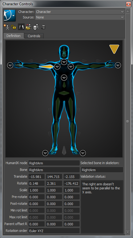

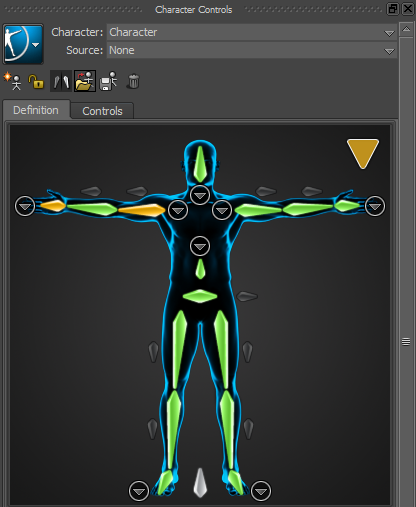

In the Character Controls window, the Character representation in the Definition pane displays a yellow symbol (
) indicating problems have been detected with the characterization.
The issues with the characterization are described at the bottom right of the Character Definition pane. Hovering with your mouse over the yellow symbol also displays the issue(s).
In this example, the right arm and right hand don't seem to be parallel to the X axis.
In the Character representation Definition pane, click or double-click the right arm node.
The skeleton's right arm is highlighted in the Viewer window and in the Character representation Definition pane.
Double-clicking the right arm node highlights only the RightArm node in the Character representation as shown in the following figure.
Character representation displays focus on right arm node

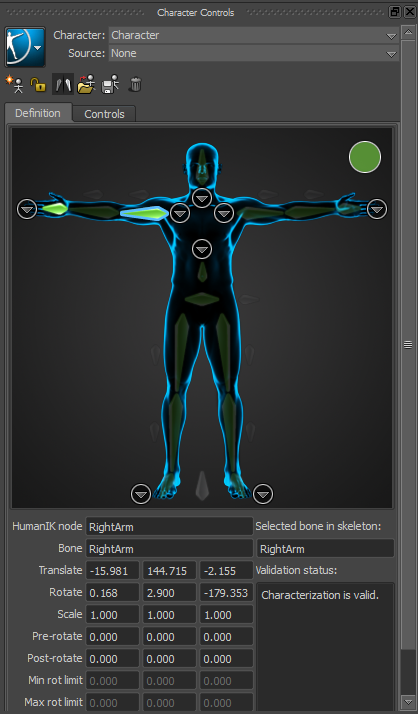

The Definition pane displays the RightArm values.

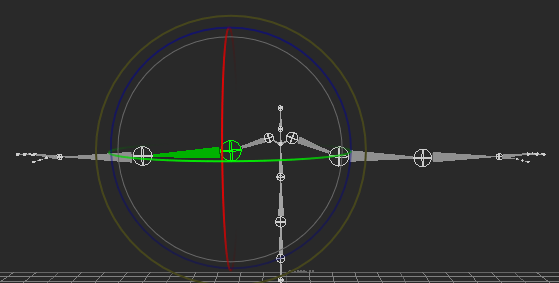

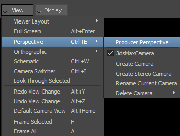

In the Viewer window, click the View menu and choose Perspective Producer Perspective (or press Ctrl-E).
In the Viewer window Camera View Navigation toolbar (
), drag the Zoom tool (
) or Ctrl-drag to zoom in on the skeleton.In the Viewer window toolbar to the right, click the Rotate tool (
) or press R to enable rotation.
In the Viewer window, drag the outer Rotation manipulator (X, Y, Z) slightly downward until you see the Character representation display a valid characterization as shown in the following figure.
The changes to the rotation values resolved the characterization issues and therefore, the characterization is valid.
The green symbol (
) indicates the characterization is valid.
