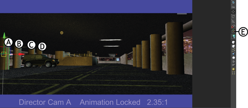

The following figure displays a parking lot scene in the Viewer window. The scene displays a car, which is parked between the pillars B and C. Each pillar in the scene is an object.
Camera view of a parking lot scene in Viewer window A, B, C, D Pillars E. Temporary Pivot Shift icon

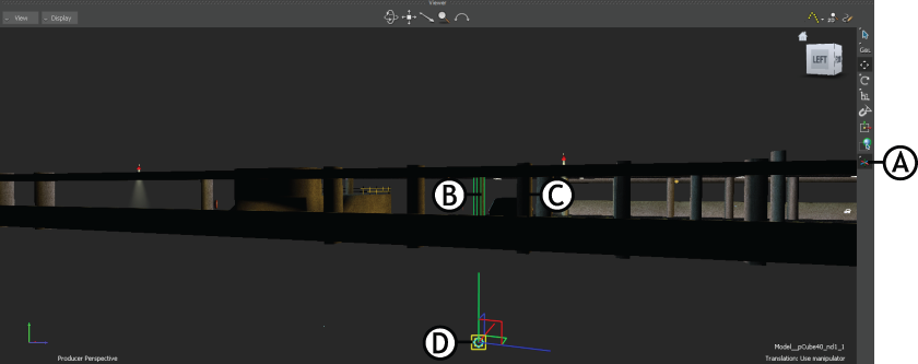

In the following figure, the pivot of the pillar B is offset at some distance from its center. The offset location of the pivot is not visible in the normal camera view. To view the actual offset position, you need to rotate the scene until you locate the pivot.
Parking lot scene rotated to locate the pivot of pillar C A. Pivot Mode B, C Pillars between which the car is parked D. Offset location of the pivot of pillar C
In a virtual production environment, if the director want to immediately reposition all the pillars (A, B, C, and D) on the scene, then it is time consuming to rotate the scene, locate the offset position of each pillar, and drag them to the center point of each pillar, before repositioning them.

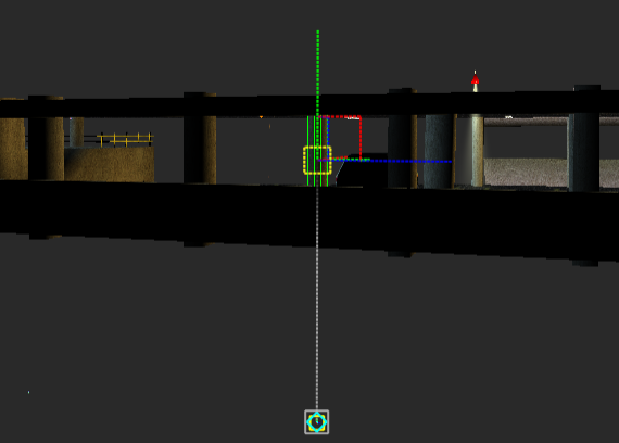

The pivot moves from the offset position to the center of the bounding box of the object, as shown in the following figure:
Notice that the coordinates of temporary pivot and the line that connects the offset location and the temporary shift to the bounding box center appears dotted. This specifies that the shift from offset pivot location to the center of an object is only temporary.
