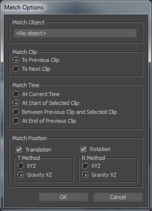

The Match Options dialog box consists of the following areas:
Match Object menu
Match Clip options
Match Time options
Match Position Options

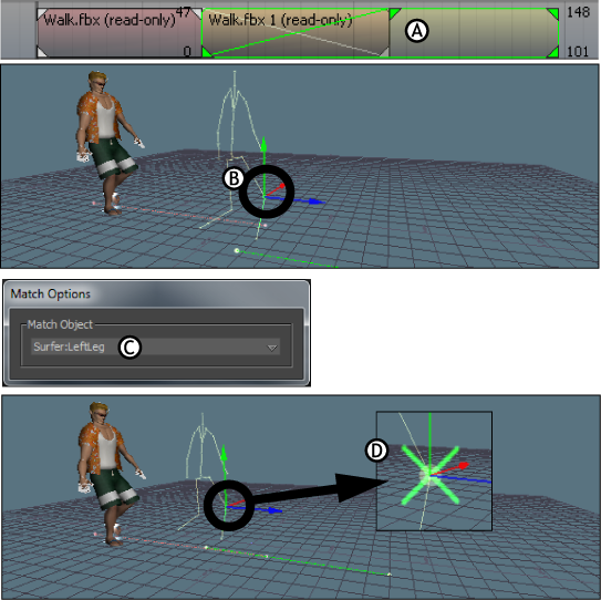

Match Object menu
Use the Match Object menu to select which part of the track content used to match clips.
You can also disable the match object so that the blend does not take it into account when you match clips. See the Blend Algorithm menu section in Blend Algorithm menu for more information.
You can also select a match object using the Match Object field and button. See Match Object field for more information.
Choosing a new match object A. Select the clip B. Select the new match object C. The name of the new match object appears in the Match Object menu. D. The match object is used when you click Match.
Match Clip options
The Match Clip options in the Match Options dialog box let you select which clip you are matching. There are two choices: To Previous Clip, where the selected clip is matched to the clip before it on the track, or To Next Clip, which matches the selected clip the clip after it on the track.

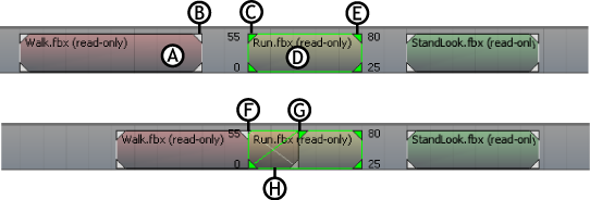

The Match Time options let you select at which point of a cross-blend the selected clip is matched.
Cross-blend A. Previous clip B. Previous clip’s Out point C. Selected clip’s In point D. Selected clip E. Selected clip’s Out point F. Blend start G. Blend stop H. Mid-blend
The Match Time options change depending on which Match option is selected.
When matching clips, it is always the selected clip that plays in the Viewer window.
