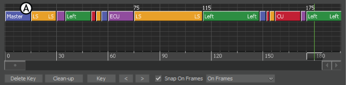

    Camera Switches and Keyframes A. Camera switches in the Camera switcher
  6. Advance the timeline indicator to the position of the next key, select the appropriate Camera Color, and click Key again.
    The new key is set from that position forward.
  7. To set the next switch, advance again, select a camera, and click Key, and so on.
