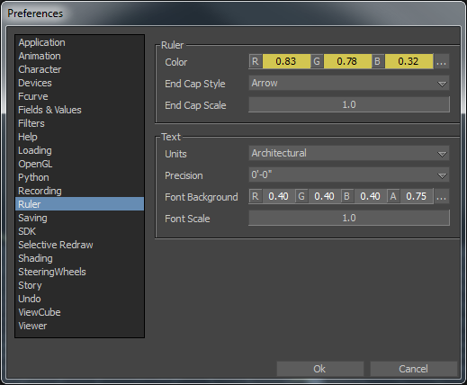

The Preferences window include the Ruler preference settings.
The Ruler preference settings enable you to change the default Ruler display settings and the default measurement unit.
To access the Ruler preferences, do either of the following:
  • Right-click the Ruler and choose Preferences from the context menu.
  • From the menu bar, select Settings Preferences and in the Preferences window, click the Ruler preference option.
Ruler preferences

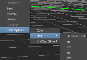

To change the Ruler default settings via the Viewer window:
Note:
A system Ruler object is required.
  1. In the Viewer window, right-click the system Ruler object.
    A context menu displays.
  2. Choose the Path Options context menu to access the Ruler preference settings.
The Ruler preference settings can be accessed via the Path Options contextual menu.
The following tables describe the Ruler preference settings.
Description
Color
The Color setting enables you to change the default color of the system Ruler object (as displayed in the Viewer window) and to the highlighted object or element.
End Cap Style
The End Cap Style setting enable you to specify the end point style of the system Ruler object.
End Cap Scale
The End Cap Scale setting enable you to specify the size of the Arrow End Cap Style of the system Ruler object. The value can be set between 0.1 and 10.
Font Background
The Font Background settings enables you to change the background color of the unit measurement display of the system Ruler object.
Font Scale
The Font Scalesetting enables you to specify the size of the unit measurement display of the system Ruler object. The value can be set between 0.1 and 10.
The Ruler measurement unit options include Architectural (feet and inches), mi (miles), cm (centimetres), m (metres), and km (kilometres). The default measurement unit is set to Architectural.
