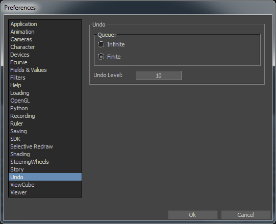

To access the Undo preferences:
From the menu bar, select Settings > Preferences.
In the Preferences window, click the Undo preference option.
The Undo preference settings display.
The Undo stack lets you select an Infinite or Finite set of undos. If you select a Finite queue, you may want to reduce the Undo Level to save memory and speed up MotionBuilder. The default Finite undo value is 10.
