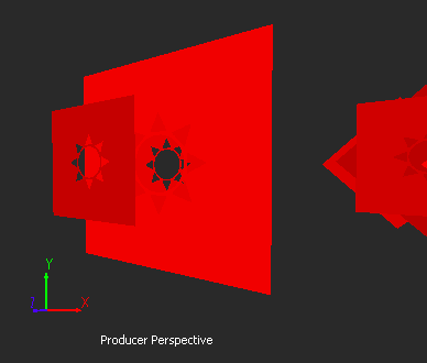

The following figure shows the transparency threshold of textures for all geometric elements in the scene.

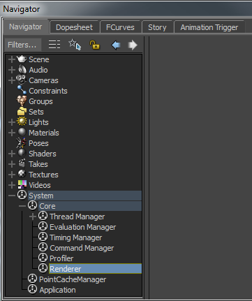

In the Navigator window, expand System, expand Core, then click Renderer.

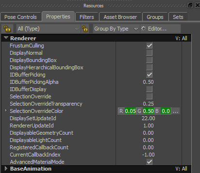

In the Renderer's Properties, enable IDBufferDisplay.

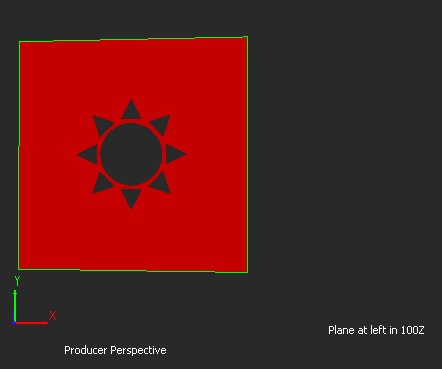

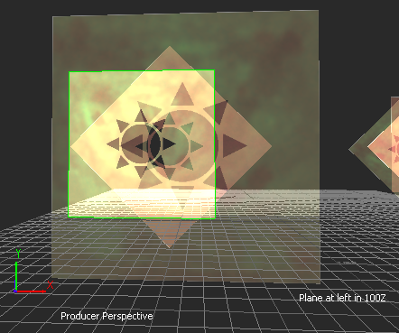

).In the Viewer window, click a partially transparent textured geometric element.
The following figure shows the foremost geometric element is selected.
Selected elements are shown with a highlighted border.

The textures' transparency threshold value is shown in the Renderer's IDBufferPickingAlpha property field. The following figure shows the textures' transparency threshold is set to 0.50.
IDBufferPickingAlpha property specifies the textures' transparency threshold

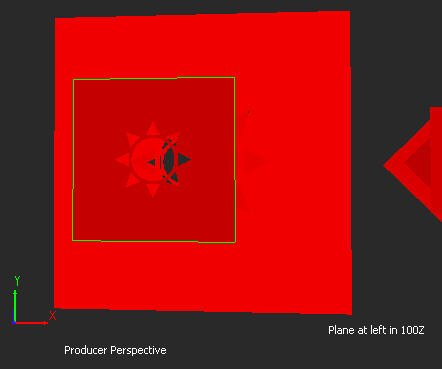

Setting the textures' transparency threshold to 0.50 means that 50% of the textures' transparency is considered when selecting occluded geometry. See the result in the following figure.
