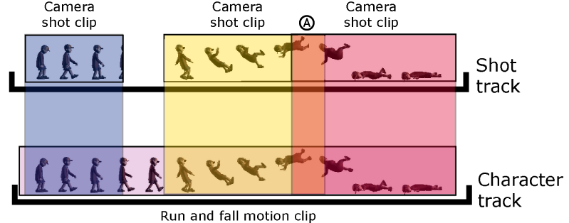

A shot clip represents action captured with a single camera. You can use multiple shot clips to create a series of camera switches on the Edit timeline, but unlike the Camera Switcher, you can also blend your shot clips to create cross dissolves as shown in the following figure.
Camera shots on the Edit timeline covering the corresponding areas of the action on the Character track on the Action timeline A. Two camera shots blended creating a cross dissolve
