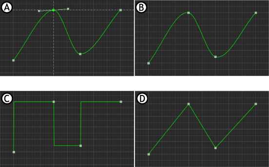

The animation differs depending on the interpolation mode. For example, a model animated along the X axis in the Auto interpolation mode moves left and right gradually, while the same model animated in Stepped interpolation mode suddenly appears in different locations at each keyframe.
The following figures show a graphical representation of each interpolation mode.
FCurves window A. Auto interpolation B. TCB interpolation C. Stepped interpolation D. Linear interpolation
The slope of a function curve determines the speed at which the values change between keyframes. A steep slope means the value changes quickly, and a gradual slope means the value changes more slowly over a longer period of time.
