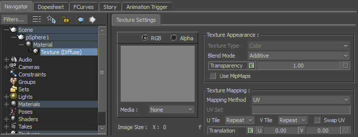

  4. In the Scene browser, double-click Texture (Diffuse) to access the Texture Settings.
    Navigator window Texture Settings pane

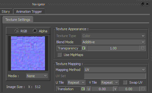

    The Texture Settings pane displays the preview of the texture.
    Navigator Window Texture Settings pane

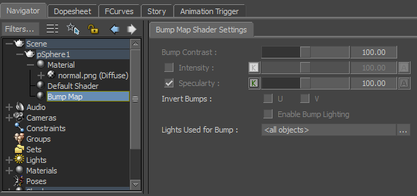

    In the Navigator window, the Bump Map Shader Settings pane displays and the Scene browser displays the Bump Map attached to the Material.

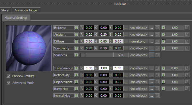

  1. In the Navigator Scene browser, double-click the object's Material branch to access the Material Settings.

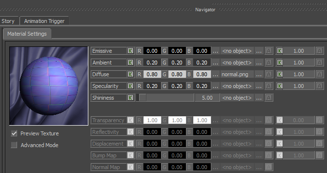

    Material Settings
    The Material Settings pane displays a texture attached to the Material's Diffuse property, and a thumbnail view (Preview Texture) of the texture.
    The Material's Transparency, Reflectivity, Displacement, Bump Map, and Normal Map properties are not available when the Advanced Mode is disabled.

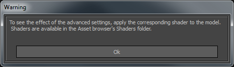

  2. In the Material Settings, enable Advanced Mode.
    A warning message displays.
    The Material Settings Advanced Mode enables you to access the settings that require a shader to display the result in the Viewer window.
  3. Click OK.
    The Material Settings in the Advanced Mode are now accessible.

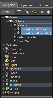

  4. In the Navigator Scene browser, under the object's Material branch, drag the texture *.* (Diffuse) in the Material Settings pane onto the Material's Bump Map property ().
    The Navigator Scene browser and Material Settings pane show the texture is now attached to the Material's Bump Map property.

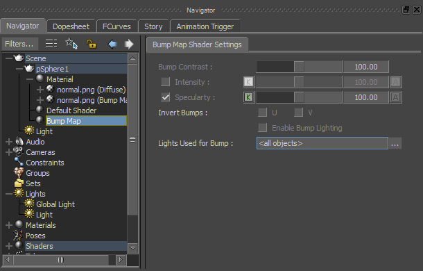

  1. In the Navigator Scene browser, double-click the Bump Map shader to access the Bump Map Shader Settings.
  2. In the Bump Map Shader Settings, fine-tune the effect by enabling Intensity and changing the Bump Contrast, Intensity, and Specularity values, and by enabling Invert Bumps and Enable Bump Lighting, and by choosing a Light to use for Bump.
