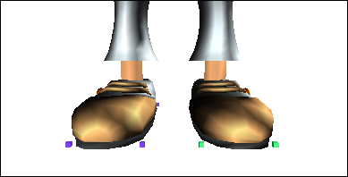

Floor Contact
Lets you define how the feet, hands, fingers, and toes of a character should react when they are in contact with the floor of your scene. See Floor contact for more information on setting up floor contact for a character.
Green and blue markers around the feet of a character

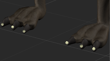

Finger Tips
Contact spheres used to display the finger tips or toes of a character. The finger tips for a quadruped character display in the following image.
Finger tips of a quadruped character
