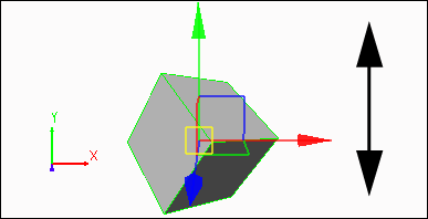

For example, in the following figure, Global Reference mode is selected so that when the object is translated along the Y-axis, it moves along the global Y-axis.
Global Reference mode: The marker translates along the global Y-axis.

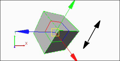

For example, in the following figure, Local Reference mode is active, so the marker is translated along its local Y-axis.
Local Reference mode: The marker translates along the local Y-axis.
