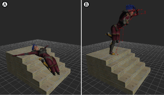

You can use character poses in a Ragdoll solve so you can define how a character collapses or falls. Using poses in this way is useful if you want to create a specific reaction or impression.
Ragdoll solves A. Without pose B. With pose (shown in red)
