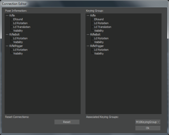

Use the Connection Editor to map channels between a custom object keying group (either “Object Type” or “Global”) and a pose—so that when you apply that particular pose to another object, the only properties that are keyed are the specific ones you’ve selected. You can create many object poses with the same keying group—and then use the Connection Editor to create a mapping of object keying group properties to pose properties that is unique for each pair (keying group and pose).
This feature is particularly useful if you’re keying many different instances of the same type of object or character movement. For example, your scene may have two different gun props in it—each with bolts and triggers. The action (or poses) of each gun may be the same (the bolts and triggers may move the same way), but some properties will be different (textures, rotation and translation may be “local” for each gun). Using the Connection Editor, you can map specific properties that will always be the same for some keying groups and poses, while the gun objects can still have their own local keying groups maintained.
To customize the mapping between keying group properties and a pose:
Create an Object Keying Group of either “object type” or “global”. See Creating a custom keying group.
Create a pose that uses the custom keying group created above.
In the Pose Controls window, right-click the new pose in the Pose browser, and select Display Connection Editor.
Select a Pose Information property from the left column, and then in the right column, click the Keying Group property you want to map it to.
- You can undo your mappings by clicking Reset. This will restore the default mappings that were created automatically for the pose between corresponding properties.
Click OK to close the Connection Editor and save the relationship between the pose and the keying group.
