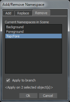

    The Add/Remove Namespace dialog box appears, displaying in numeric alpha order the namespaces in the scene.
  3. Click the “Remove” tab.
    Selected object’s or branch’s namespace highlighted
  4. Do one of the following:
    • If you want to delete the namespace for the selected object, disable “Apply to branch” option.
    • If you want to deleted the namespace for all objects within the selected branch, enable “Apply to branch” option.
