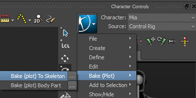

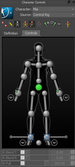

Go to the Character Controls window.
Left-click the Character Controls window menu button, choose File
Bake (Plot)
and click
for the Bake (plot) to Skeleton menu option.
The Character dialog displays.
In the Character dialog, in the Plot Rate field, choose 24 FPS and then click Plot.
All the animation data is transferred from the Control rig to the character’s skeleton on the BaseAnimation layer of the current take.
