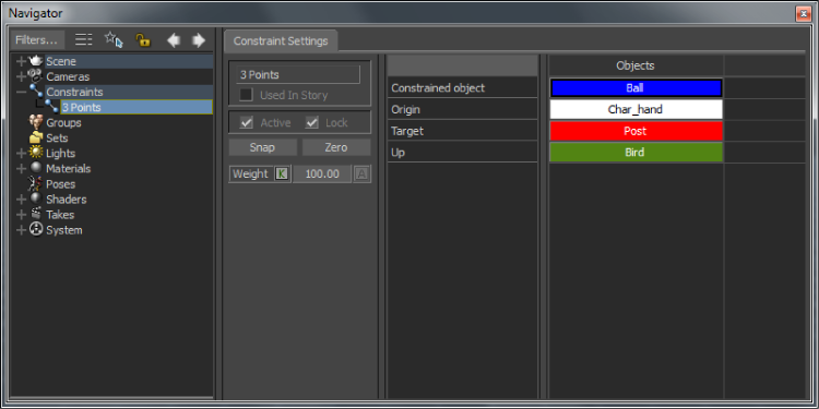

When you first activate or snap the Rotation From 3 Points constraint, it aligns the constrained object’s X-axis with the vector defined by the Origin and Target sources. The constraint then attempts to align the Y-axis of the constrained object to point towards the Up source.

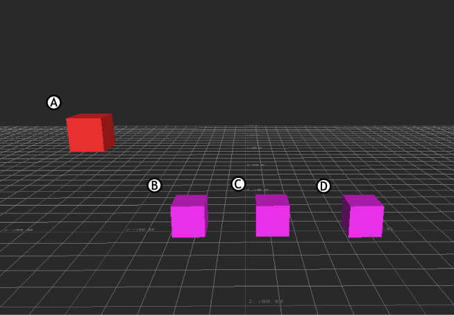

3 Points constraint A. Constrained object B. Up source object C. Origin source object D. Target source object
In the following graphic, the cube A is the constrained object. When you move any of the three cubes (the sources) after the constraint is active, the X, Y, and Z rotation of the constrained object changes.

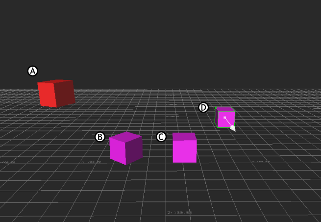

3 Points constraint activated: Translating B, C, and D rotates the constrained object (A) in various directions
If you rotate or scale the source objects, it does not alter the constrained object.
