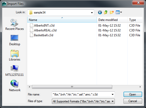

    The Import Files dialog box appears.
    Import Files dialog
  2. Navigate via the Import Files dialog, and select the file to import.
  3. Click Open.

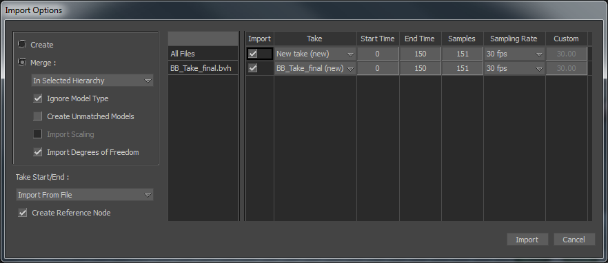

    Import Options dialog for .bvh file format with Merge options

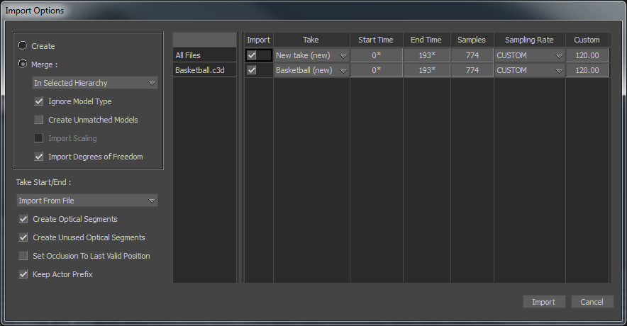

    Import Options dialog for .c3d file format with Merge options

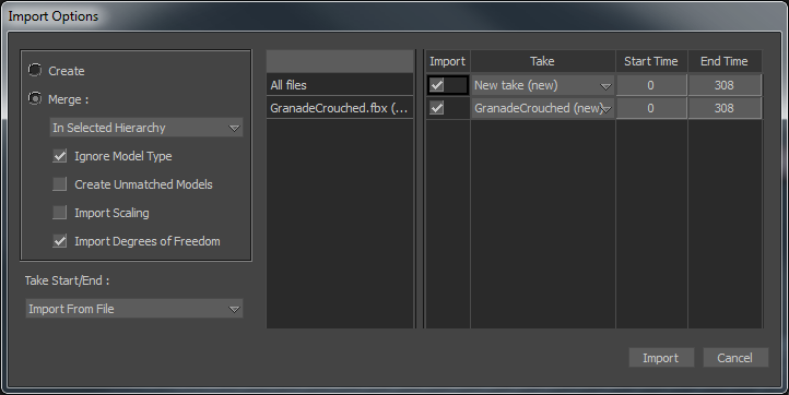

    Import Options dialog for .fbx file format with Merge options

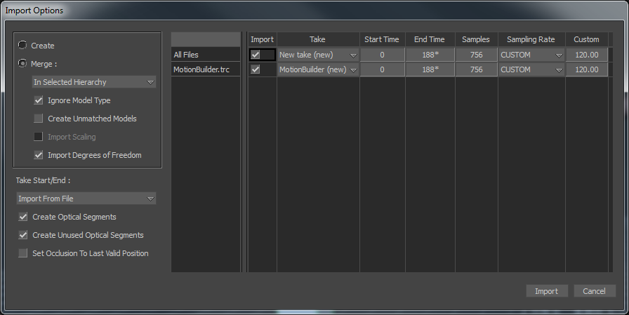

    Import Options dialog for .trc file format with Merge options
