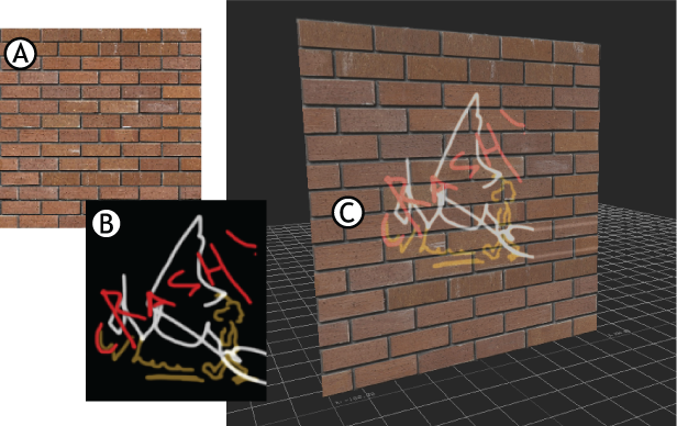

Note:If your textures have alpha channels, you can create interesting blending effects, such as a grass texture giving way to a pavement texture. To use a texture’s alpha channels, apply a shader with a Transparency setting, such as the Lighted shader, to the model.
Blending textures A. Tiling brick texture B. Graffiti texture with alpha channel C. Both textures combined on one model using a Layered texture
