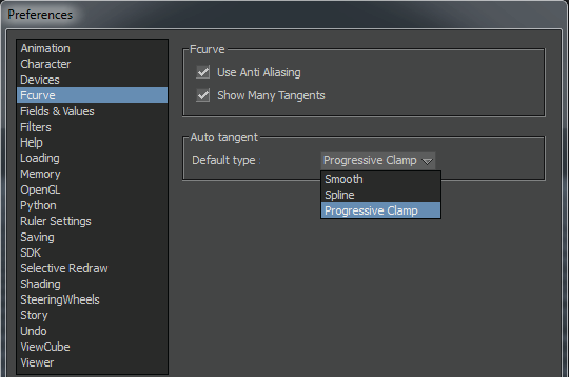

Auto option
Auto interpolation mode automatically adjusts the tangents of an Auto key type, based upon the interpolation of the previous and next keys. How this tangent will be affected is based upon one of the Auto types, which you can choose from the FCurve Preferences window.
Auto tangent default types in the Preferences window
The following table describes the default types of Auto tangent:
There are two options in the FCurves context menu, Switch to Fixed on Edit and Reset Tangents on Switch to Auto, that affect your use of Auto and Fixed modes.

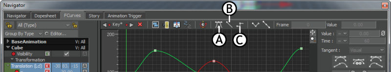

Stepped option
Maintains the same keyframe value between keyframes. With Stepped interpolation mode active, there is no slope between keyframes. This option replaces the behavior of Constant in previous versions of MotionBuilder.
While working in Classic Mode, clicking the Stepped option on the FCurves window toolbar displays the Set Keys to Constant Normal and Set Keys to Constant Next options (B and C in the figure).
Tangent options A. Stepped option is active B. Set Keys to Constant Normal option C. Set Keys to Constant Next option

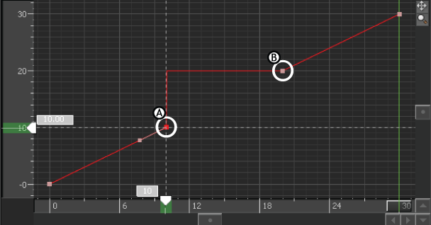

When this option is active, Stepped interpolation maintains the value of the selected keyframe until the next keyframe.
Step interpolation A. Selected keyframe B. Next keyframe

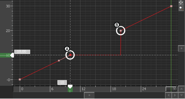

When this option active, Stepped interpolation maintains the value of the next keyframe between the selected and next keyframes.
Step Next interpolation A. Selected keyframe B. Next keyframe
The Set Keys to Constant Next interpolation is useful for marking the end of a referential when using the Multi-Referential constraint.
